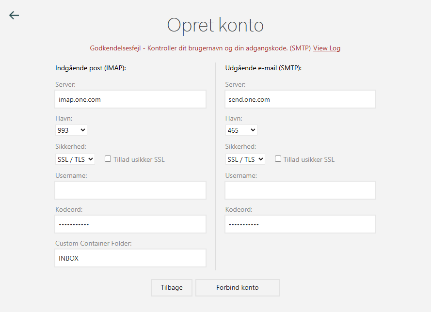

SMTP not working after updating to 1.17.2
  1. Reply or new email.
  2. Send to any email.
Can send email on smtp (send.one.com).
1.17.2 (It works again, when i installed 1.17.0 again).
  • OS and Version: Windows 11 Pro - 24H2
    • Installation Method: mailspring.exe
  • Mailspring Version: 1.17.2
I got this error in the log :
----------SMTP----------

mailsmtp Last Error Code: 296
mailsmtp Last Error Explanation: Unknown
mailsmtp Last Error Location: 10
mailsmtp Last Auth Type: 2
1.17.3 appears to fix the issue.
This SMTP authentication issue was introduced in v1.17.2 and fixed in v1.17.3. Please update to the latest version (v1.21.1 as of May 19, 2026) — SMTP should work correctly. If you’re still seeing Error 296 on a current version, please reply with your provider and Mailspring version and we’ll investigate.
