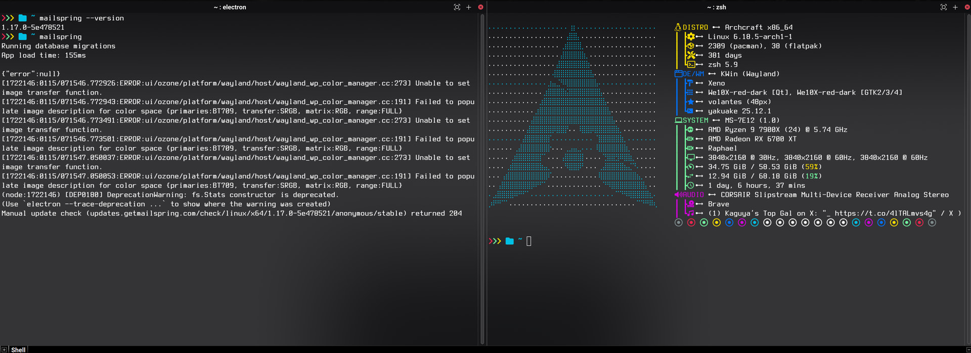

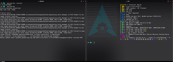

I have successfully used Mailspring for over a year and various version updates on this system. After the recent update to v1.17 which preports to have new Wayland support, my Mailspring will execute, and I get the icon in my system tray, but the application window itself refuses to show. I tried running it from the terminal to see what was breaking. Below are the errors I get. They have to do with Wayland color profiles, I believe. I later ran the app with “–ozone-platform=x11” to force the app to use X11 and it opened and worked fine like that. Though native Wayland support would be great, so I look forward to this being fixed. Great work, Mailspring team! Love the application.
  1. Have the new V1.17 on a system with native wayland.
  2. Run the applicaiton from command line and see the errors.
The application should open without forcing X11
Below are my systems specs, OS versions, and Mailspring version all from the terminal so you know they are exact and correct. I install the package mailspring-bin from the AUR.
