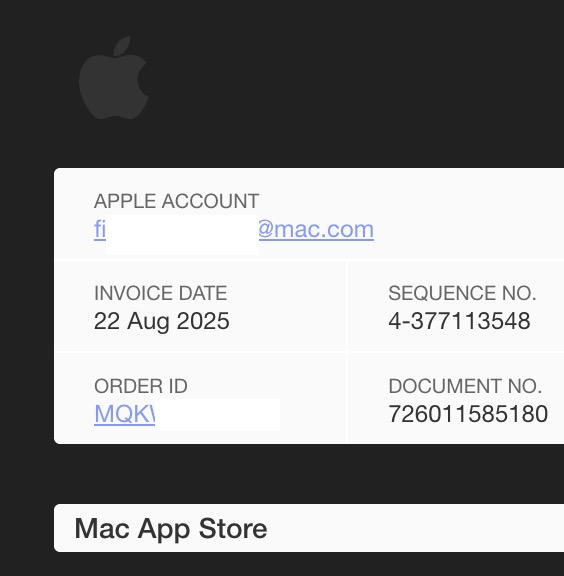

Example from the builtin dark theme, an Mac App Store receipt email body:

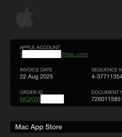

And this built on Mailspring Theme Starter (just changed primary color from green to blue):

And then I changed the primary color from green to blue (as you see in the bright screenshot above).
So, does anyone know how to either find the builtin Dark theme, so I can steal from that, or how to get the same, nice and dark, message body?
